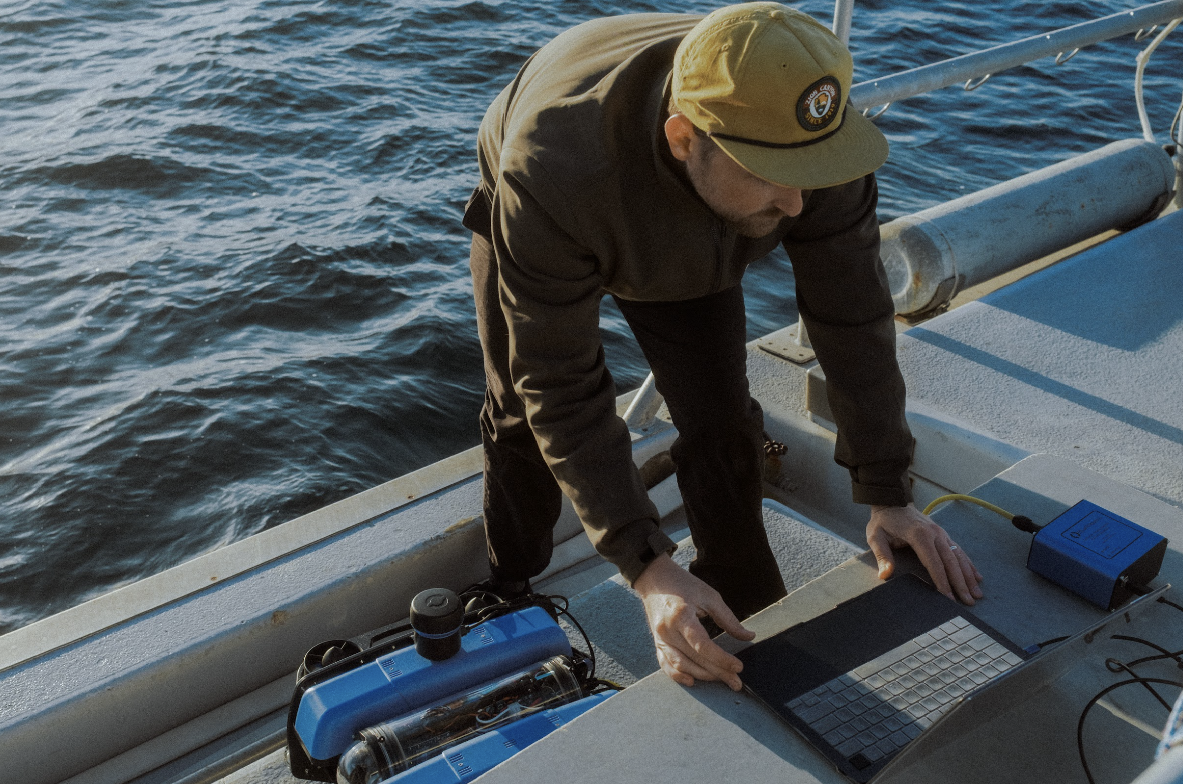

The BlueROV2 is controlled by the Navigator Flight Controller and BlueOS. The Navigator is designed and built for ROVs and other robotics applications. It has onboard sensors, including an inertial measurement unit (IMU) to measure orientation, a magnetometer to measure compass heading, and a leak sensor to alert you of any water ingress. It has 16 outputs that can be connected to thrusters, lights, grippers, and other accessories as well as plenty of serial and I2C ports to communicate with sensors and sonars. It has plenty of room for expandability!
The Navigator is coupled with a Raspberry Pi 4 computer, which handles all of the processing and computing requirements within the ROV. It runs our open-source BlueOS software that provides the tools and features necessary to operate and expand the vehicle. BlueOS runs the ArduSub vehicle control software, manages the camera and tether connection, and makes it easy to install extensions to add new features. BlueOS is always improving, and new capabilities will continue to roll out to all BlueROV2s.
At the surface, the pilot controls the ROV with a gamepad controller and a laptop running Cockpit, our open-source ground control station. Cockpit is a highly customizable user interface for vehicle control, live video, and sensor data.

Before You Dive
Before You Dive
And while the BlueROV2 kit gives you the vehicle, there are a few essentials you will need to supply on your own. Things like a laptop, battery, and charger are not included in the kit, but are required to operate your ROV. Here are our recommendations to help you choose the right setup:
  • Laptop – We recommend a medium to high-end model with Windows 11, Mac, or Linux operating systems. Check out the system requirements in the Technical Details section below. iOS and Android are not officially supported at this time.
  • Battery – We recommend our 14.8v, 18Ah lithium-ion battery for the best battery life, but we can’t ship it to all locations! There are a number of other compatible batteries that can be used as well. We’d recommend getting a few for extended operation.
  • Battery Charger – We have a recommended charger as well, but any lithium-ion battery charger that can handle your battery will work!
