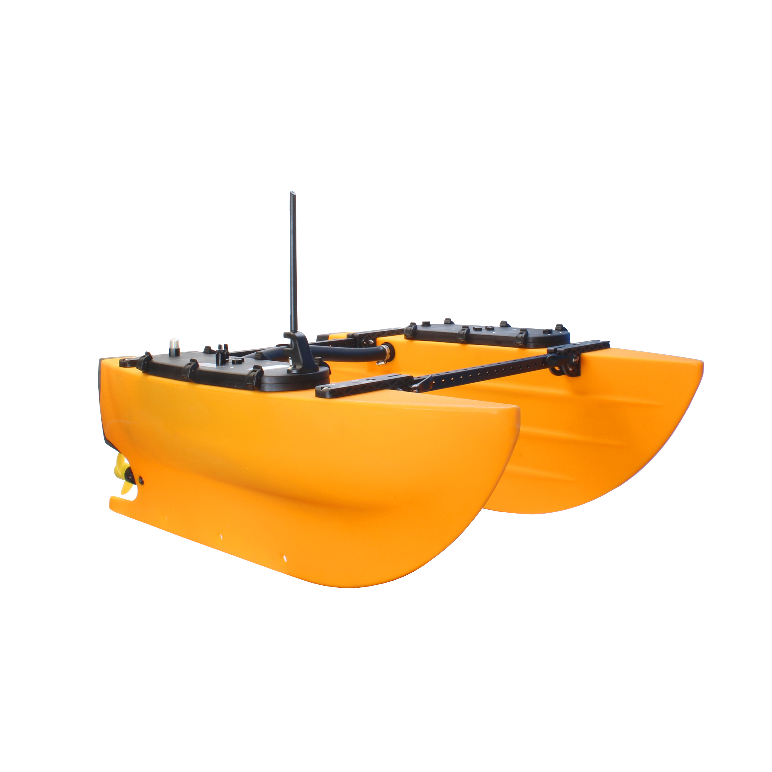

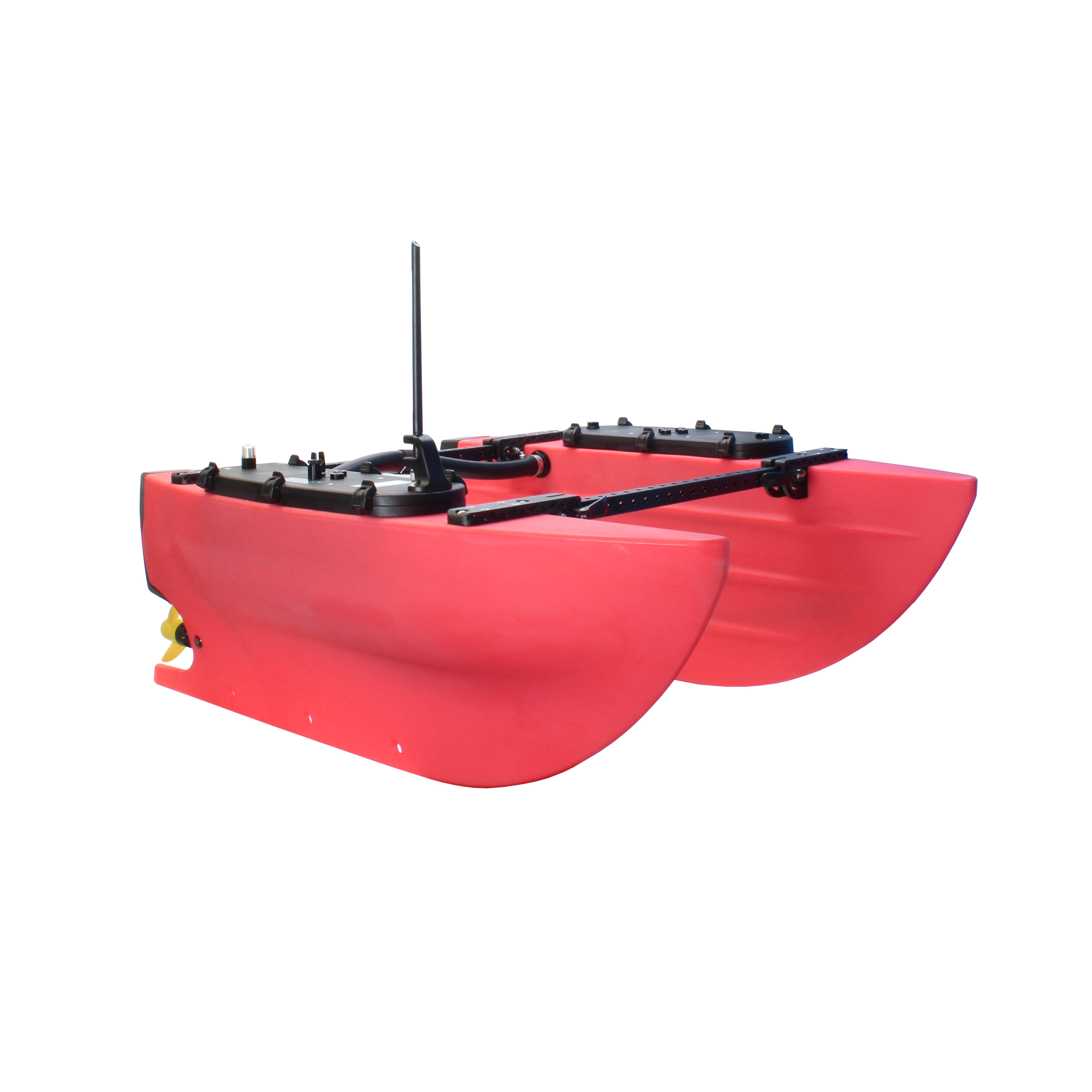

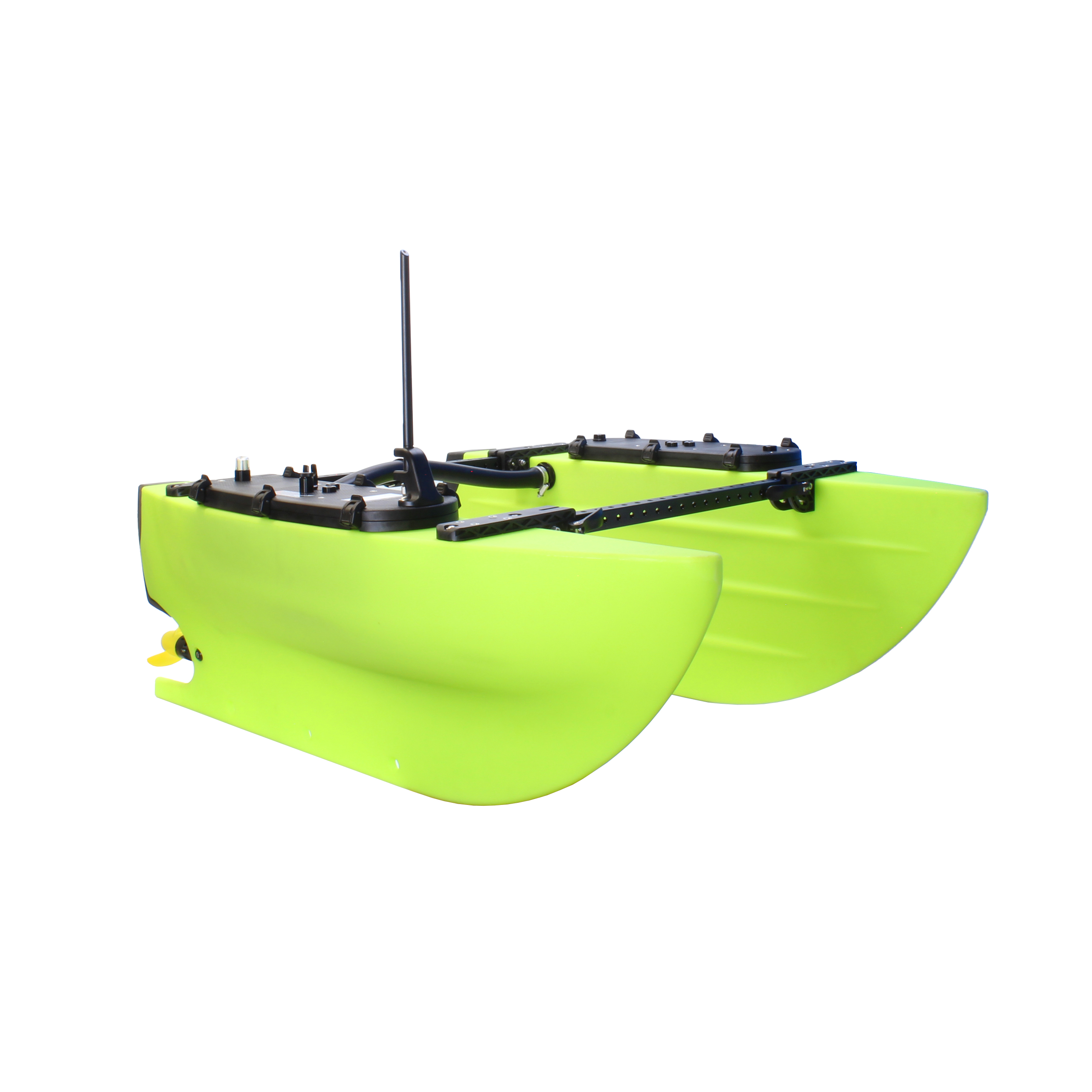

The BlueBoat was born from a desire to make uncrewed surface vessels just as easy to get started with as ROVs and drones. Even with many options on the market, we saw a lot of room for improvement. We started from a clean sheet and designed the vehicle that we wanted to have ourselves, then worked tirelessly to perfect it and make it as affordable as possible. The result is the BlueBoat.
The BlueBoat is the planet’s most affordable surface vessel for hydrographic surveys, robotic systems development, and scientific missions. Its weedless hull and propeller design, rugged construction, and compact transport size make it reliable and convenient to use, while its flexible electronics architecture, ample payload mounting areas, and open-source BlueOS software system make it an ideal platform for integration of sonars and other sensors.
The BlueBoat exists for you to build on top of and is easily and endlessly expandable.
It’s a hydrographer’s pickup truck
The BlueBoat is designed to carry any payload that you want to integrate and to do so better than any other vehicle its size. We fit all of the control electronics, batteries, and wiring into the hulls so that the space between the hulls is completely dedicated to payload integration. The hulls are designed with flat inner walls, creating a low-wake sensor area ideal for survey sonars.
The BlueBoat can carry up to 15 kg (33 lb) of batteries and payload. The cross members, brackets, and the bottom of the hull have mounting points so that you can mount anything, whether it’s a hydrographic survey echosounder, an enclosure full of prototype electronics, or both!
Electronics areas in both hulls leave plenty of dry space for internal hardware integration with access to dedicated payload power, interhull communications, and holes for electrical penetrators or connectors.
Combined with the open-source BlueOS software system, it’s not just integration friendly, it’s going to be your new bff 💕
Weedless. Like, actually.
From the beginning, our vision for the BlueBoat has been one of reliability and trustworthiness. We knew from our own experiences with the SolarSurfer that getting stuck on weeds or debris quickly turns your uncrewed vehicle into an inconvenient and expensive rescue situation. So we developed a unique design that eliminates that problem.
The BlueBoat’s unique deep hull shape pushes weeds and debris down and out of the way. Anything that isn’t pushed down is brushed away by highly swept weedless propellers driven by two M200 Motors. That means that whether you’re doing a bathymetric survey in a weed-filled lake or studying a plastic-polluted waterway, you can count on the BlueBoat to get it done.
BlueBoat drives effortlessly through weeds.

BlueBoat folds to a compact size for transport in most car trunks.
Just trunks, no trailers
With a folding hull and frame design, the BlueBoat fits in the trunk of just about any car. Quick release handles allow you to switch between the folded and deployed configurations in seconds.

What’s Included
The BlueBoat comes as a partially assembled kit with all electronics tested. Assembly can be completed in about 1–2 hours with hand tools. The following lists the included subassemblies and other components of the BlueBoat kit.
Hulls
  • 2 x BlueBoat hull assembly (starboard and port)
  • 2 x M200 Motor (BlueBoat variant) with mount
Frame
  • 2 x Frame bracket and frame crossmember assembly
Frame Mounting Hardware
  • 4 x M6x14 flanged button head screws
  • 8 x M6x20 flanged button head screws
Hatch Lid Assemblies
  • 1 x Starboard hatch lid assembly
  • 1 x Port hatch lid assembly
Antenna and Guard
  • 1 x Antenna assembly
  • 1 x Hatch Lid Antenna Guard
  • 2 x M6x14 flanged button head screws
Propeller Set
  • 2 x Weedless propeller (LH and RH)
  • 4 x M3x8 Socket head cap screw
Crosstube
  • 1 x Crosstube assembly
  • 1 x Cross cable
Crosstube Hardware
  • 2 x Crosstube C-nut
  • 2 x -129 O-ring
  • 1 x Hook and loop strap with buckle
  • 1 x Molykote 111 silicone grease 6g
Flagpole
  • 1 x BlueBoat Flagepole with flag
  • 1 x Flagpole mount
  • 1 x M5x5 cup-point set screw
Battery Cables
  • 2 x 4S splitter cable
  • 1 x Charge cable
Tools
  • 2 x BB120 Wrench
  • 1 x 2.5 mm hex driver
  • 1 x 4 mm hex key
  • 1 x 5 mm hex key
Fuse Spares
  • 1 x 150A MIDI fuse
  • 2 x 50A MIDI fuse
  • 5 x 2A MINI blade fuse
  • 5 x 5A MINI blade fuse
  • 5 x 10A MINI blade fuse
Spare Hardware
  • 2 x M6x20 flanged button head screws
  • 2 x M4x10 flanged button head screws
  • 2 x M3x8 socket head cap screw
  • 2 x M5x5 cup-point set screw
  • 1 x Frame clamp thumb nut
Other Components
  • 1 x USB Ethernet adapter
  • 12 x Frame bushing spares
  • 1 x Microfiber towel
  • 1 x Sticker set
  • 8 x Velcro strip
  • 2 x 70% Alcohol wipe

Performance
Endurance @ 1 m/s (~30 W), no payload:
2 Batteries (532 Wh, 2.4 kg)18 hrs (65 km)
4 Batteries (1064 Wh, 4.7 kg)36 hrs (130 km)
6 Batteries (1596 Wh, 7.0 kg)50 hrs (180 km)
8 Batteries (2128 Wh, 9.3 kg)62 hrs (220 km)
Solar Power (user equipped)Indefinite
Maximum Speed (2 batteries, no payload)3 m/s 6 kts
Maximum Static Thrust8.2 kgf18 lbf
Temperature Rating (air)-25 to 40°C-13 to 104°F
Temperature Rating (water)0 to 40°C32 to 104°F
SteeringSkid Steering
Payload and Expansion Capabilities
Payload Capacity (batteries + payload)15 kg33 lb
Payload PowerBattery Voltage @ 60 A (Direct Connection)
Battery Voltage @ 10 A (Fuse Board)
5V Auxiliary @ 5 A (Fuse Board)
Penetrator Holes (Starboard Hatch Lid)
2 x M10
Area to drill more
Penetrator Holes (Port Hatch Lid)4 x M10
2 x M14
Area to drill more
Available Ports and Interfaces3 x Serial UART
Ethernet (Blue Robotics Ethernet Switch required)
2 x USB 2.0
2 x USB 3.0
1 x 16-bit ADC (3.3 V)
1 x 16-bit ADC (6.6 V)
Dimensions (Length x Width x Height)120 x 93 x 46 cm (deployed)
120 x 71 x 24 cm (folded)
120 x 46 x 20 cm (packaged)
47 x 36.5 x 18 in (deployed)
47 x 28 x 9.5 in (folded)
47 x 18 x 8 in (packaged)
Weight (no batteries or payload)14.5 kg32 lb
Freeboard (2 batteries, no payload)160 mm6.3 in
Maximum Draft (maximum payload)320 mm12.6 in
Propulsion2x M200 Motor w/ Weedless Propeller
Propeller Diameter112 mm4.4 in
Navigation Light5V 2W LED, White All-Around, Programmable Flashing
Primary MaterialsLDPE (hulls)
30% Glass-filled Polycarbonate
Anodized Aluminum
Stainless Steel
