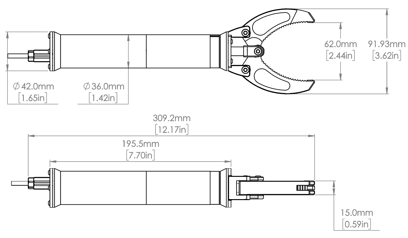

The gripper has jaws that open to grab objects up to 2.44″ or 6.2cm in diameter. The plastic jaws are mounted with custom aluminum screws to create a corrosion resistant mechanism that doesn’t need any lubrication. The jaws are driven by a linear actuator that uses a geared brushed motor and lead screw. The main body is air-filled and sealed with O-rings. We’ve spent a lot of time testing it at pressure and it’s rated to 300m depth with plenty of safety factor.

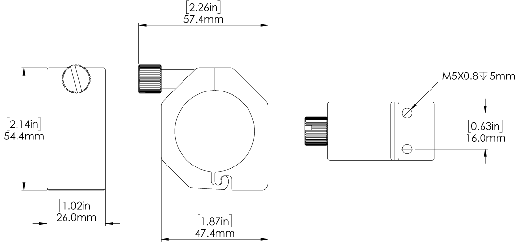

The gripper comes with everything needed to use it on the BlueROV2, including an anodized aluminum mount that uses a thumbscrew for quick retraction and rotation in the field. The mount attaches with two included M5 screws.

Linear Piston Travel13.5 mm0.53 in
Jaw Opening62 mm2.44 in
Time to Open/Close1.6 secs

Housing MaterialAluminum 6061-T6
Pressure Rating300 m984 ft
Overall Length (Closed)303.2 mm11.94 in
Overall Length (Open)309.2 mm12.17 in
Body Primary Diameter36 mm1.42 in
Bracket Mounting Hole Spacing16 mm0.63 in
Bracket Screw SizeM5x0.8
Weight in Air (w/ cable)524 g18.5 oz
Weight in Water (w/ cable)267 g9.4 oz

Newton Gripper Assembly
Newton Gripper Assembly Drawing
Newton Gripper Mount
Newton Gripper Mount Drawing
