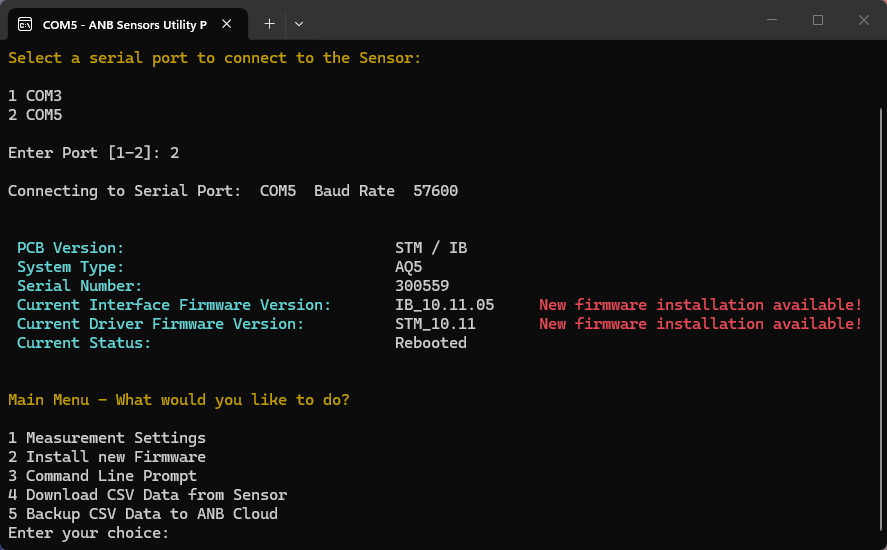

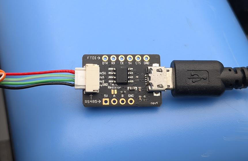

3. Connect the 4-pin JST GH connector from the pH sensor to the RS-485 input on the BLUART, then use a micro USB cable to connect the BLUART to your computer.
  • You’ll need to know the correct COM port for the sensor. If you have other USB devices connected, it can be hard to tell them apart—open Windows Device Manager, navigate to Ports (COM & LPT), and watch for the new entry as you plug in the BLUART.
Once the sensor is connected and you’ve identified the COM port, launch anb_utils and connect to the sensor. If a firmware update is available, the program will notify you (this requires an internet connection). Follow the on-screen instructions to update.
anb-ph-brov2-integration-2
The sensor’s measurement settings are also configured through anb_utils. Each setting option is explained here.

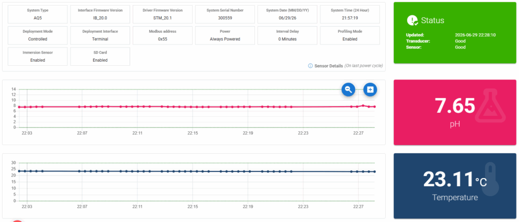

4. Launch ANB GUI and select the COM port from the dropdown. The sensor’s information should appear in the Sensor Details area at the top.
5. Select START to begin scanning. The sensor takes a few minutes to self-calibrate before displaying its first measurements—please be patient! After a few minutes, you should see values plotted on screen.

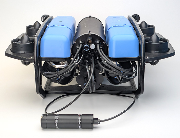

Connect the Sensor
The ANB pH sensor communicates via RS-485, so you’ll need a USB-to-RS-485 adapter, such as the BLUART, to connect it to the internal Raspberry Pi.
1. Connect the 4-pin JST GH connector from the pH sensor to the RS-485 input on the BLUART.
anb-ph-brov2-integration-9

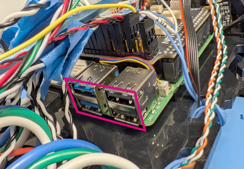

2. Use a micro USB cable to connect the BLUART to one of the USB ports on the Raspberry Pi.
anb-ph-brov2-integration-16

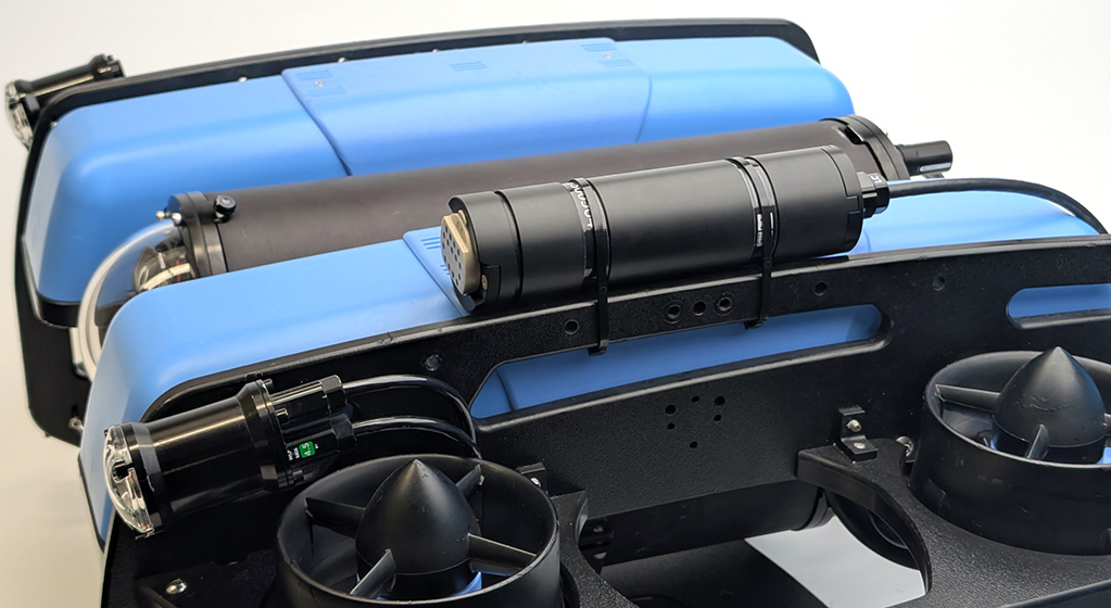

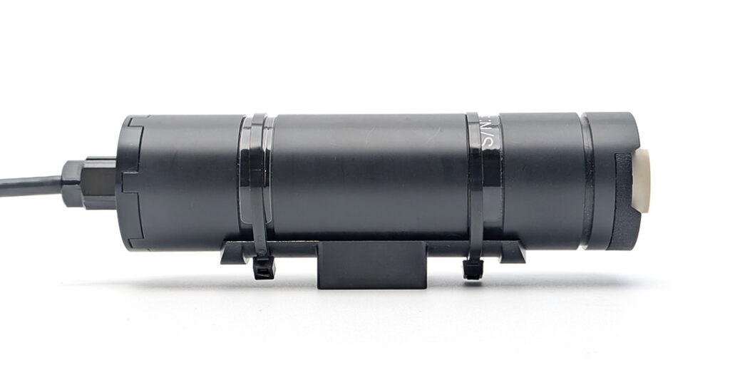

The ANB pH sensor includes a mounting bracket and hardware and can be mounted in any orientation, giving you a lot of flexibility when installing it on the BlueROV2. The following sections describe three mounting methods.
Using Cable Ties Only
This method is quick and easy, but still very secure. Use the included cable ties to attach the sensor to a convenient spot on the ROV frame.
  • Wherever you choose to mount it, make sure the sensor and its cable don’t obstruct a thruster.
  • Seat the cable ties in the sensor’s mounting grooves to prevent it from sliding out over time.

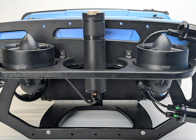

Using the Mounting Bracket
The mounting bracket provides a more permanent mounting option by attaching directly to the ROV frame with screws. This method requires drilling four mounting holes through the frame.
You’ll need:
1. Choose a location on the ROV frame for the sensor and mounting bracket, making sure the sensor and its cable won’t obstruct any thrusters.
2. Print the mounting template at 100% scale and use it to mark the four mounting hole locations on the frame.
  • Printing at a different scale will cause incorrect hole spacing.
3. Drill the four mounting holes through the frame.
4. Use the two included cable ties to secure the sensor to the mounting bracket, ensuring the ties are seated in the sensor’s mounting grooves and wrap around both the sensor body and the bracket.
anb-ph-brov2-integration-7
5. Use the four included M3×16 screws and the 2.5 mm hex tool to secure the bracket to the frame. The screws should pass through the frame and thread directly into the bracket.
anb-ph-brov2-integration-11

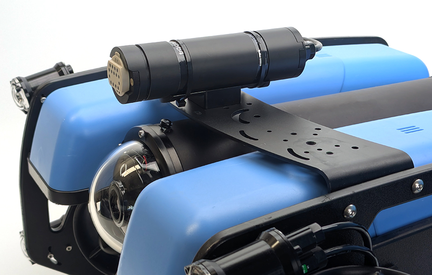

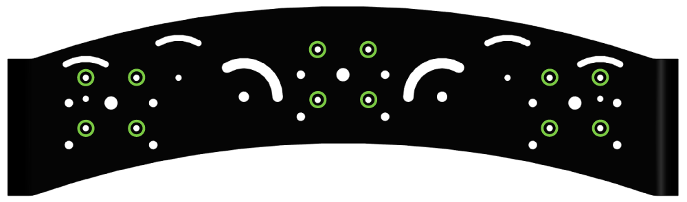

Using the BlueROV2 Roof Rack
The mounting bracket can also attach to the BlueROV2 Roof Rack.
You’ll need:
1. Use the two included cable ties to secure the sensor to the mounting bracket, ensuring the ties are seated in the sensor’s mounting grooves and wrap around both the sensor body and the bracket.
2. The mounting bracket can be installed in any of these positions on the Roof Rack.
ANB-ph-roof-rack
3. Use the four included M3×8 screws and 2 mm hex tool to secure the sensor to the Roof Rack.
4. Follow the Roof Rack installation guide to mount the rack to the ROV.
anb-ph-brov2-integration-5

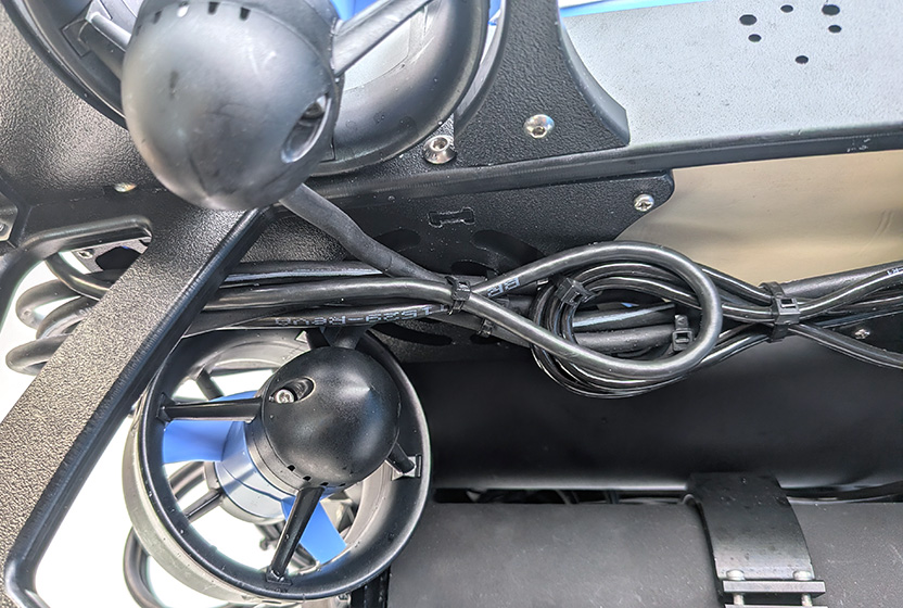

Cable Management
Good cable management ensures that loose cables are secured to the ROV frame, preventing them from getting caught on obstacles or damaged by the thruster propellers. Use cable ties to fasten the cable to the frame, ensuring there are no loose sections. Once secured, double-check that no cables can reach a thruster propeller.

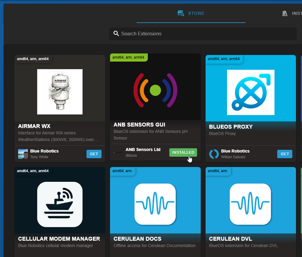

Install ANB Sensors BlueOS Extension
The ANB Sensors GUI BlueOS extension looks and functions just like the ANB GUI desktop application, providing a user-friendly interface for viewing sensor data and general operation. It can be installed from the BlueOS extensions store.
1. Power up your BlueROV2 and connect it to your computer. If you don’t know how to do that, please check out the BlueROV2 Software Setup guide first.
2. Access BlueOS (the BlueROV2’s operating system) by entering 192.168.2.2 or blueos.local into a web browser address bar.
3. Connect the BlueROV2 to a Wi-Fi network.
4. Update to the latest stable release of BlueOS using the instructions here, then return to this guide.
5. Go to the Extensions menu in BlueOS and install the ANB SENSORS GUI extension.
anb-ph-brov2-integration-17
6. After it’s installed, open it from the left sidebar. Expand the Device Identification panel and select the FTDI device from the list.
  • If more than one FTDI (BLUART) device is listed, you can identify the correct one by the USB port it’s physically connected to.

7. The sensor’s information should appear in the Sensor Details area at the top. Select START to begin scanning. The sensor takes a few minutes to self-calibrate before displaying its first measurements—please be patient! After a few minutes (~ 4 minutes), you should see values plotted on screen.

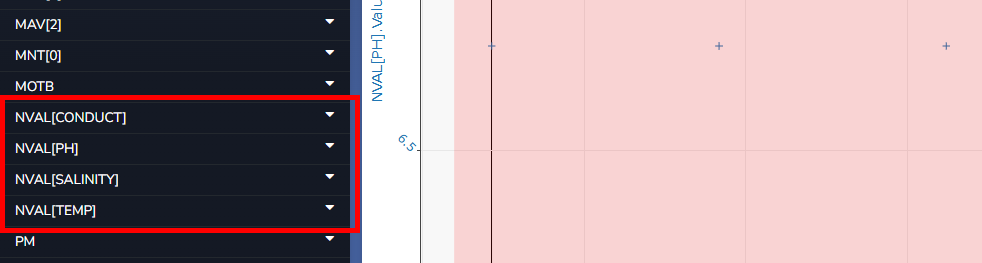

Sensor Data in Autopilot Logs
While the sensor is used with the ANB Sensors GUI extension, measured data is automatically logged in the vehicle’s autopilot log. The data is saved as the following named values:
  • NVAL[CONDUCT]
  • NVAL[PH]
  • NVAL[SALINITY]
  • NVAL[TEMP]
The values can be searched and plotted using the BlueOS Log Browser.
