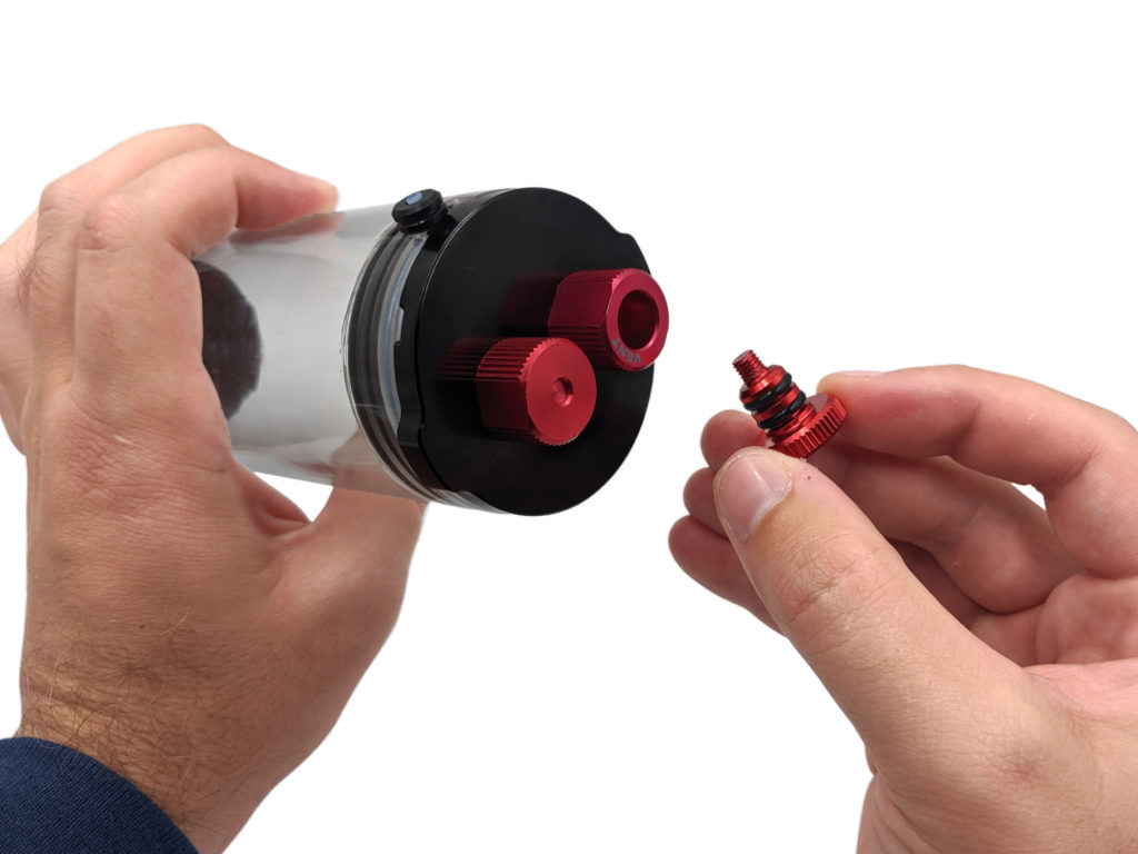

Every Watertight Enclosure should have a vent or Pressure Relief Valve (PRV) installed. This allows the enclosure to release pressure while being opened or closed. It is strongly recommended to use a Pressure Relief Valve for safety when using the enclosure with a locking cord. The locking cord is used to secure the flanges to the tube, preventing accidental detachment. However, this additional security means that if an excessive amount of pressure builds up inside the tube, it can create an unsafe situation. The Pressure Relief Valve is designed to automatically release any internal pressure in the enclosure in a safe manner.
Pressure Relief Valve Installation and Usage
Learn how to install the PRV on your watertight enclosure and use its related accessories!
WTE Vent Assembly Guide
Quickly assemble a vent for your WTE project!

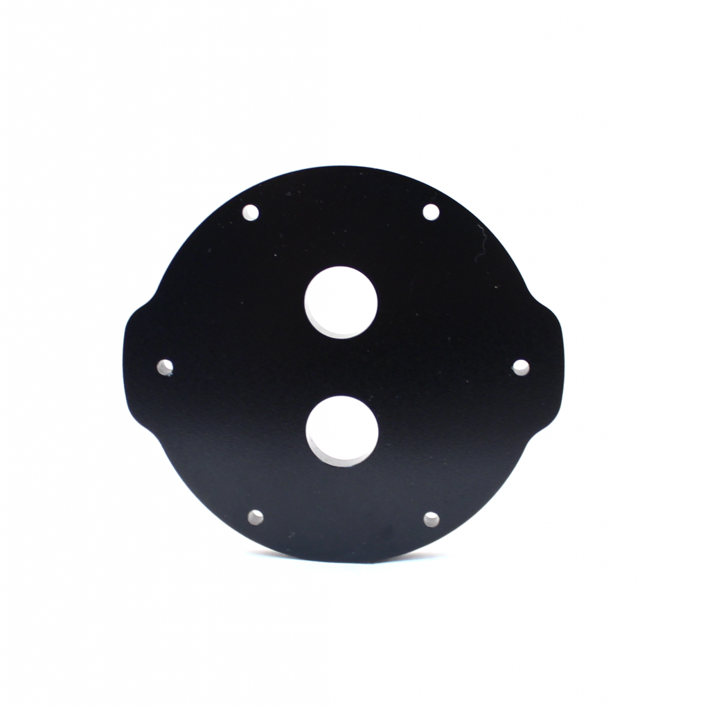

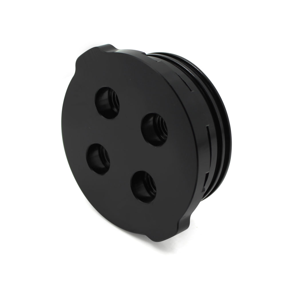

The Watertight Enclosure end caps are available in different hole configurations with M10-size holes, M14-size holes, or both. Be sure to select the correct end cap hole configuration and bulkhead sizes for your application.
M10 Holes
Most Blue Robotics products with preinstalled bulkhead penetrators use M10-size bulkheads and require an M10 end cap hole.
M10 bulkheads can be installed using the M10 size Bulkhead Wrench or a 16 mm wrench.
M14 Holes
M14 end cap holes support larger M14 size bulkhead penetrators. Currently, the T500 Thruster and the 9.5MM size WLP are the only Blue Robotics products that use an M14 size bulkhead.
M14 bulkheads can be installed using the M14 size Bulkhead Wrench or a 20 mm wrench.

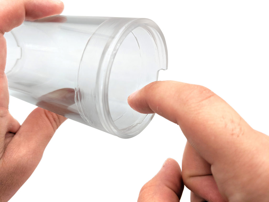

1. Inspect the inner ends of the enclosure tube, the O-ring grooves on the flanges, and the end caps to make sure they are free of scratches, damage, or dust/debris.
  • Some aluminum parts may have small discolored spots in the anodization, this is normal and won’t cause problems.
2. Apply an even layer of silicone grease (Molykote 111) to both inner ends of the tube.

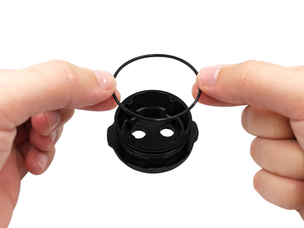

3. Apply a thin, even layer of silicone grease to the flange/flange cap O-rings and install them onto the flange or flange cap:
  • Regular flanges use three O-rings: two radial seal O-rings and one face seal O-ring.
  • 2″ series flange caps use only two radial seal O-rings.
The 2″, 3″, 5″, 6″, and 8″ series flanges use different O-ring sizes for the face and radial seals.
  • Use the single smaller O-ring for the face seal.
  • Use the two larger O-rings for the radial seals.
  • For 4″ series flanges, all the O-rings are the same size.

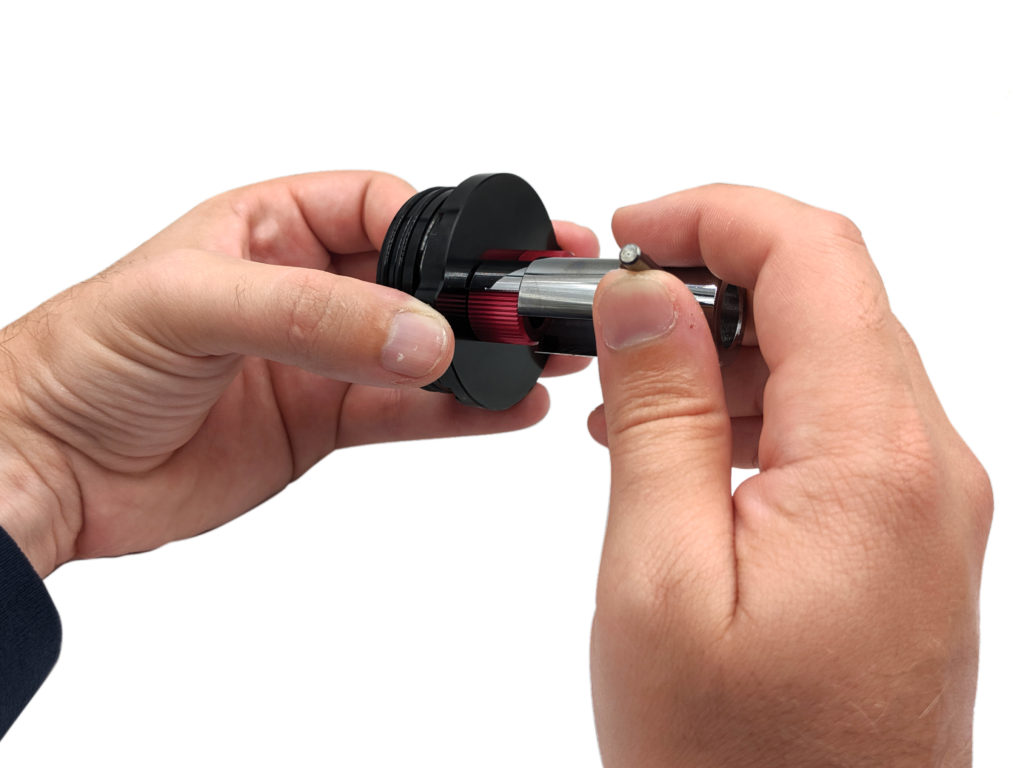

4. Install the end cap or dome onto the flange using the socket cap screws and a hex driver. Do not use thread locker on acrylic end caps or domes. Install all the screws loosely first then fully tighten the screws in a criss-cross (star) pattern. Skip this step if you have a 2″ series flange cap.
The 5″, 6″, and 8″ series enclosures may include a couple of extra end cap screws. These are spares and not needed for assembly.

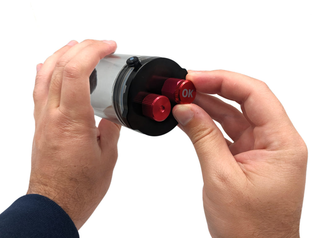

1. Remove the plug from the Pressure Relief Valve or vent.
wte-guide-assembly-15

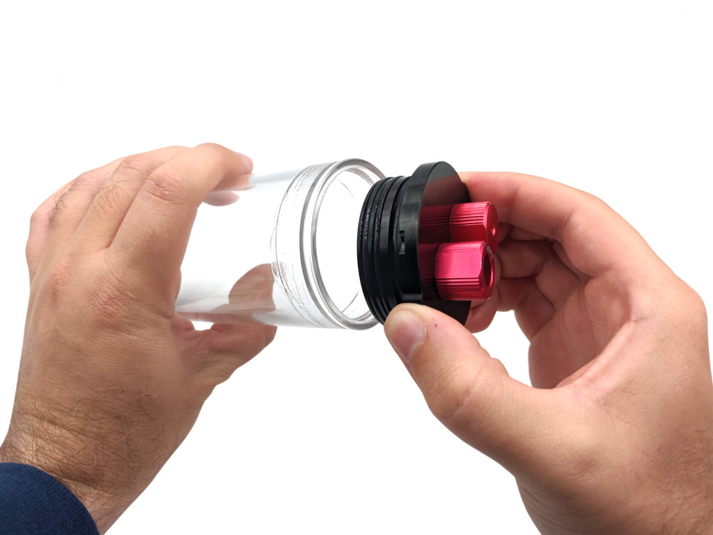

2. Install the flanges onto the tube. The flanges have a rotation locking tab that must sit in the slot in the tube to fully seat the flange.
Rotation locking tab in slot.
2. Reinstall the Pressure Relief Valve or vent plug back in the bulkhead to seal it.
prv-guide-3

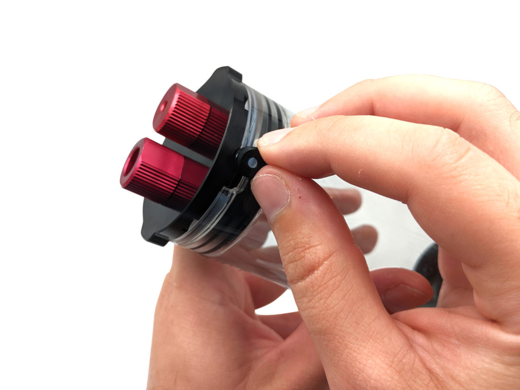

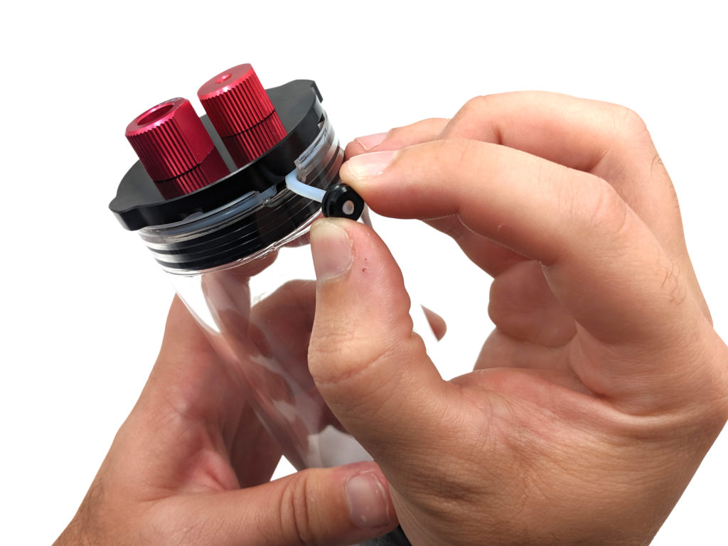

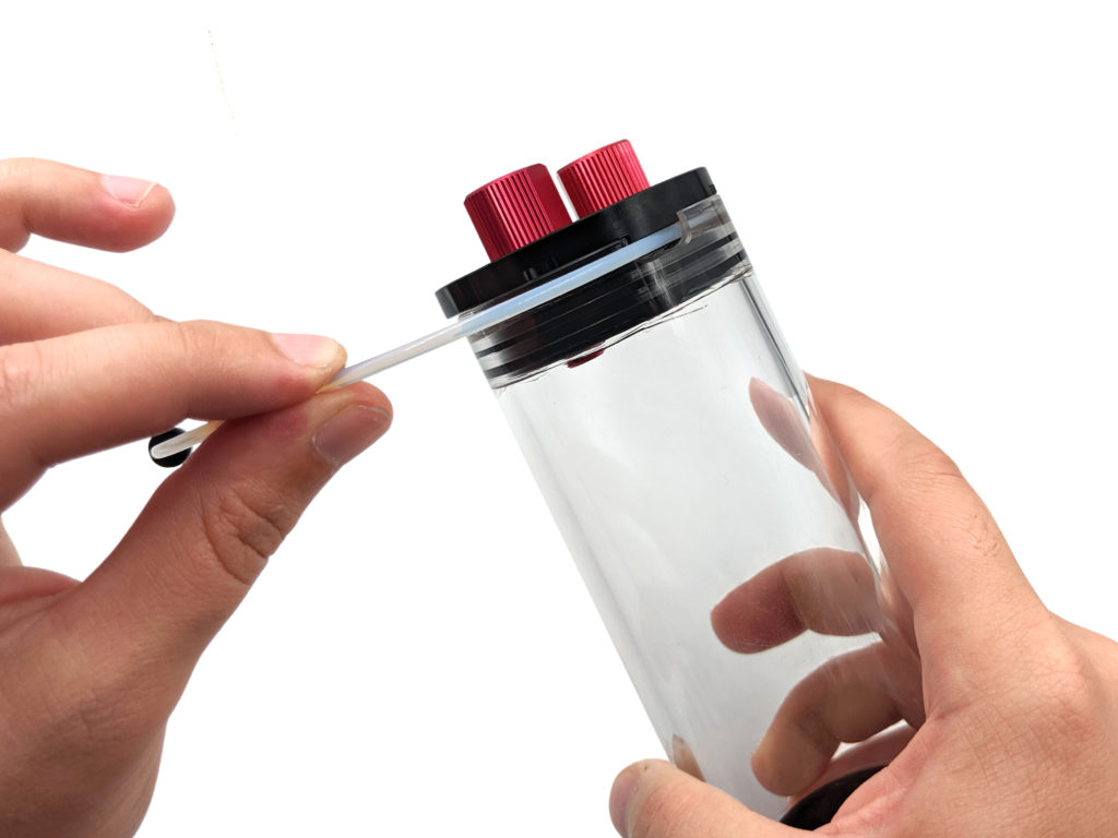

3. Insert the plastic locking cord through the slot and feed it through the locking cord channel. Push it all the way in until it reaches around to the other side. If it is difficult to push in the locking cord, it usually means the flange is not fully seated in the tube. Make sure the tab is aligned in the slot and the flange is pushed all the way in.
wte-guide-assembly-5
4. Install the locking cord handle onto the locking cord so it sits close against the tube. Tighten the set screw using a 1.5 mm hex driver.
wte-guide-assembly-6
5. Trim any excess locking cord.
wte-guide-assembly-7

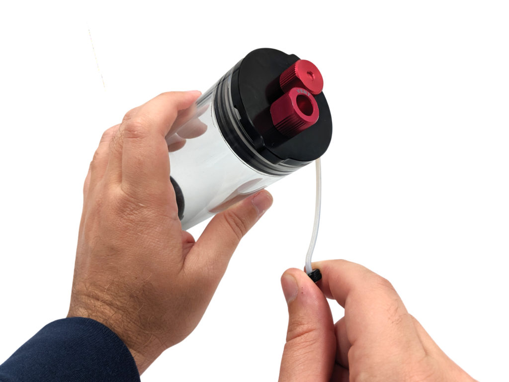

1. Remove the vent or Pressure Relief Valve plug from the bulkhead.
wte-guide-assembly-16
2. Pull out the locking cord.
wte-guide-assembly-17

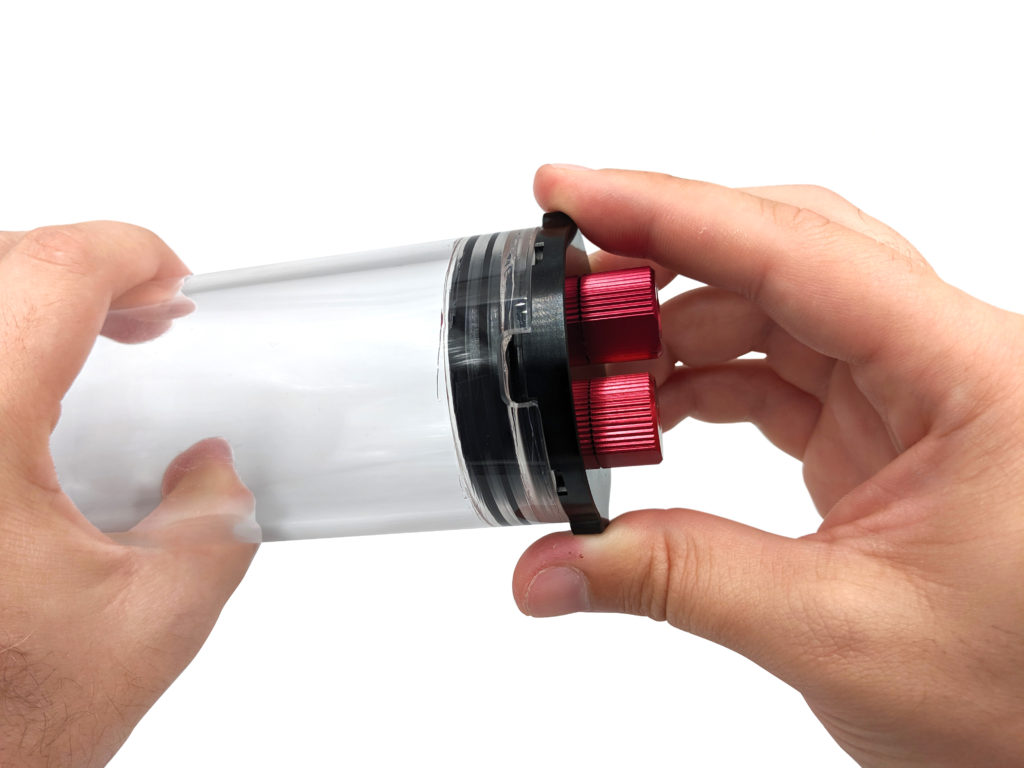

1. Make sure the vent or Pressure Relief Valve plug is not installed in the bulkhead.
2. Insert the flange fully into the tube. Make sure the rotation locking tab on the flange sits in the slot in the tube.
3. Insert the locking cord through the slot and push it all the way in to lock the flange to the tube.

Customization
Drilling holes
The acrylic and aluminum end caps can be drilled to make your own custom hole configuration. Use a 10 mm drill bit to make holes for M10 bulkheads or a 14 mm drill bit for M14 bulkheads.
