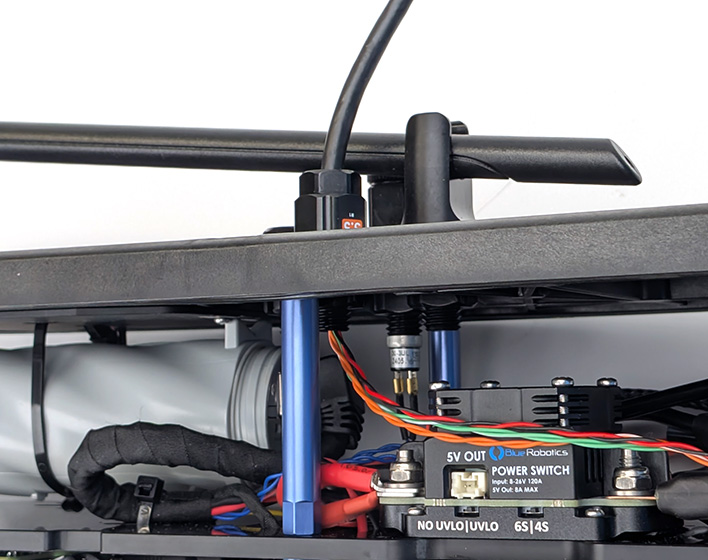

4. Use the M10 Bulkhead Wrench or a 16 mm wrench to loosen the nut from one of the blank penetrators.
ping2-integration-kit-electronics-tray-penetrator
5. Remove the bulkhead nut, O-ring, and silicone grease from the small box included with the pH sensor. Inspect the O-ring to confirm it’s clean and undamaged, then apply a thin layer of silicone grease and install it in the groove on the underside of the sensor bulkhead.
M10-bulkhead-oring-installation
6. Insert the bulkhead into the hole and fasten the C-nut on the opposite side. Tighten it by hand, then use the wrench to fully secure it.
anb-ph-brov2-integration-14
On older BlueBoats, the hatch lids have recesses shaped to hold the bulkhead in place and prevent it from turning. In this case, make sure the bulkhead is fully seated in the recess, and only use the wrench to turn the C-nut—do not attempt to rotate the bulkhead itself.
blueboat-hatch-lid-penetrator
7. Mount the electronics tray back on the standoffs using the nuts or screws you removed earlier.
8. Connect the 4-pin JST GH connector from the pH sensor to the RS-485 input on the BLUART.
anb-ph-brov2-integration-9
9. Use a micro USB cable to connect the BLUART to one of the USB ports on the Raspberry Pi.
anb-ph-brov2-integration-13
That’s it! You can now reassemble the hatchlid back on the BlueBoat.

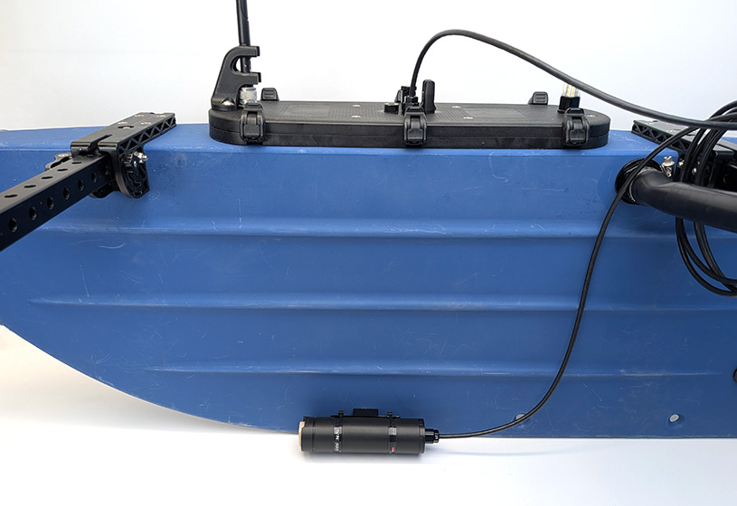

Mount the Sensor
To mount the sensor on the BlueBoat, you’ll need:
  • 5mm hex key

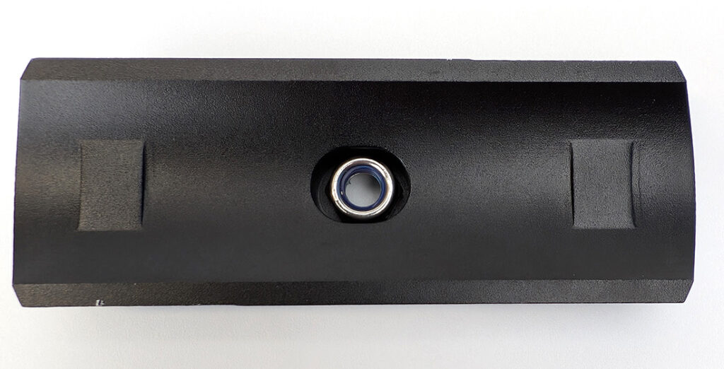

1. Insert the included M6 lock nut into the hole in the sensor mount.
anb-ph-brov2-integration-15
2. Use the two included cable ties to secure the sensor to the mounting bracket, ensuring the ties are seated in the sensor’s mounting grooves and wrap around both the sensor body and the bracket.
anb-ph-brov2-integration-7
3. The sensor can be mounted to any of the hull mounting points on either hull.
HULL_MOUNT_BUSHING_EXAMPLE4
Use the included M6x20 socket head screw, hull mount bushing, and the 5mm hex key to secure the pH sensor and mount to one of the hull mounting points.
