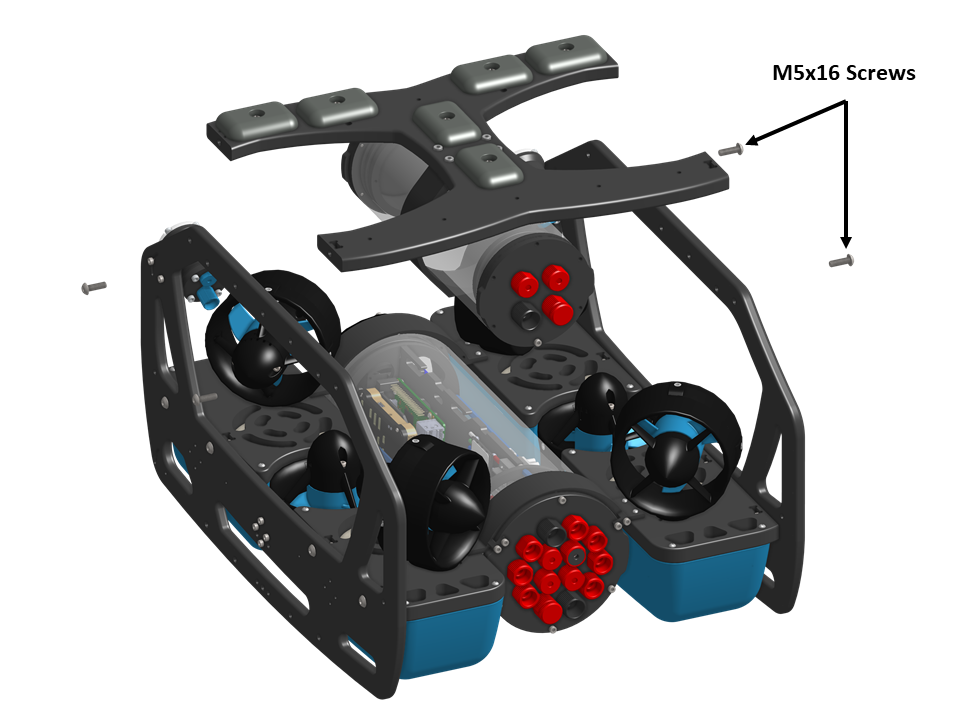

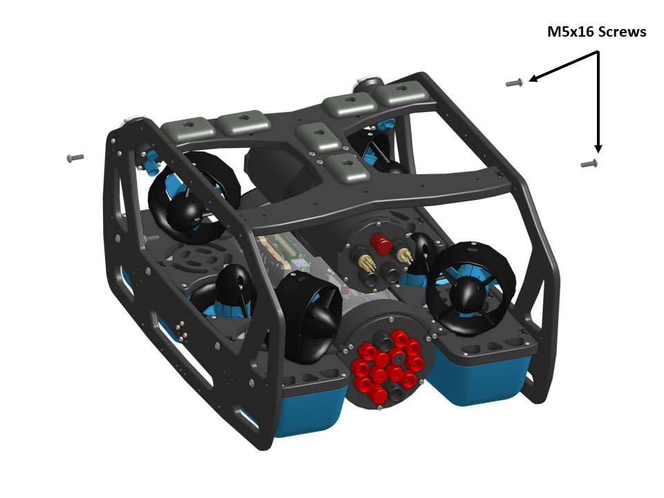

2. Remove the bottom panel from the BlueROV2 frame with a 3 mm hex key or driver.

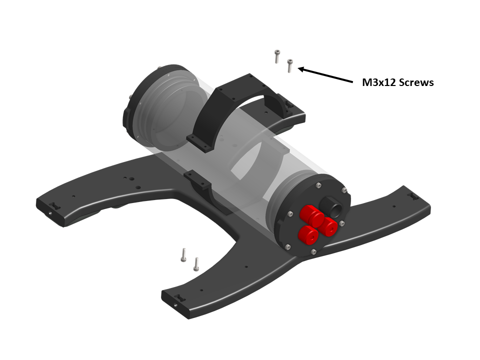

3. Remove the M3x12 screws holding the two sections of the 3″ clamp together with a 2.5mm hex driver.
4. Remove the 3″ Battery Enclosure from the clamps.

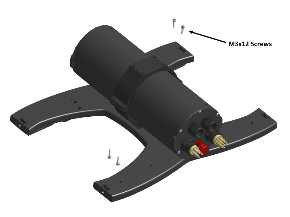

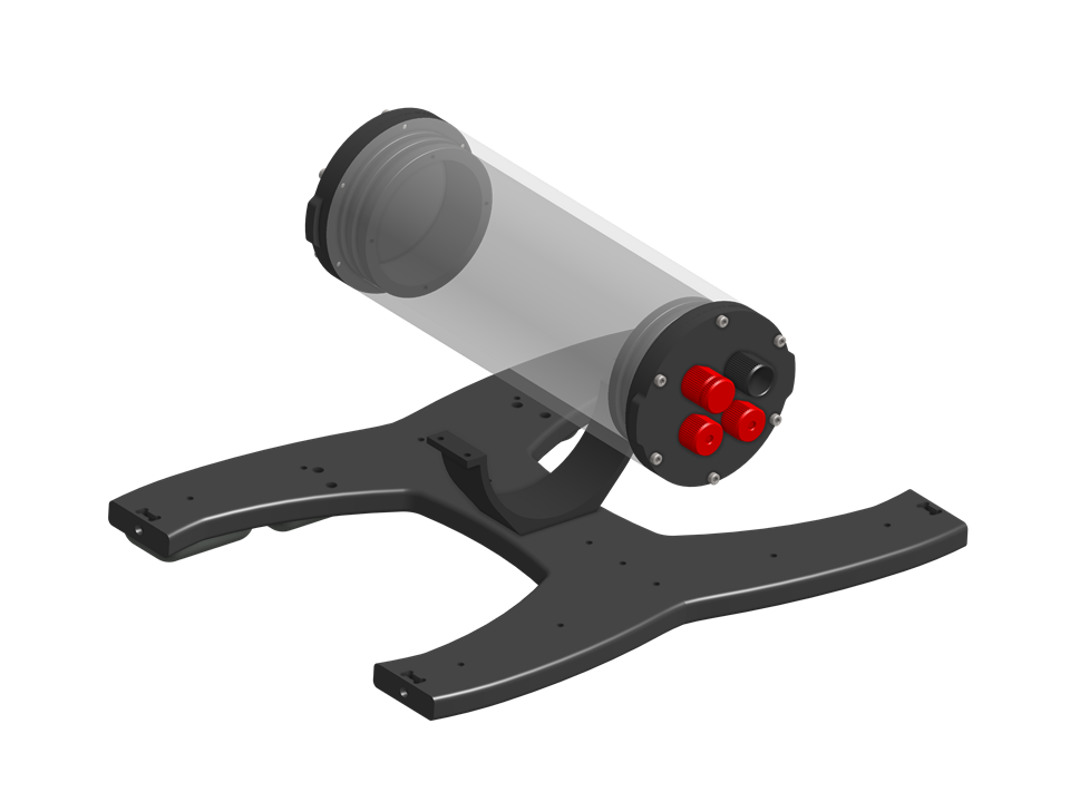

6. Place the OTPS ROV Enclosure between the two Enclosure Clamps (3″ Series). Orient the OTPS ROV Enclosure so the power cables are at the top.

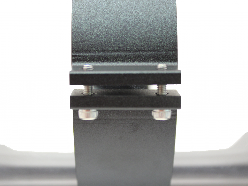

7. The Enclosure Clamps have tapped holes on one side and untapped holes on the other. Install the four M3x12 screws into the Enclosure Clamps (3″ Series) so that the screws pass through the untapped holes on the first clamp and are secured into the tapped holes on the alternate clamp. Install all four screws loosely at first and then slowly tighten them on both sides evenly. Take care not to over tighten the screws. Keep the OTPS ROV Enclosure approximately centered in the Enclosure Clamps (3″ Series).
8. When you are finished tightening the screws, both sides should look similar to this.
9. Using the four M5x16 screws that were previously removed, re-install the bottom panel onto the BlueROV2 frame. Tighten these screws using the provided 3 mm hex key.

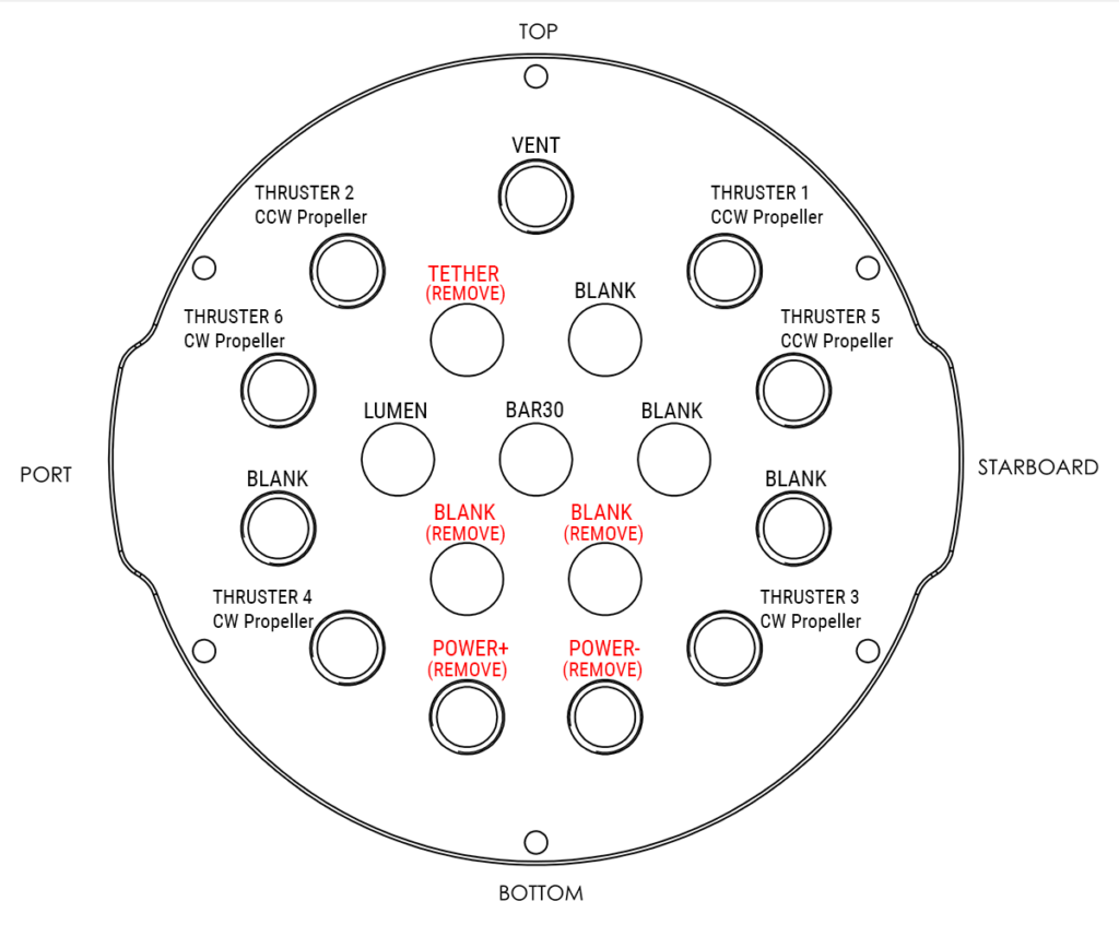

5. Remove the penetrators as shown in the pictures below using the bulkhead wrench. The penetrators that need to be removed depend on whether you have an 18-hole or 14-hole end cap. Be sure to keep the o-rings that were installed under the blank penetrators. Set these to the side as they will be used later.

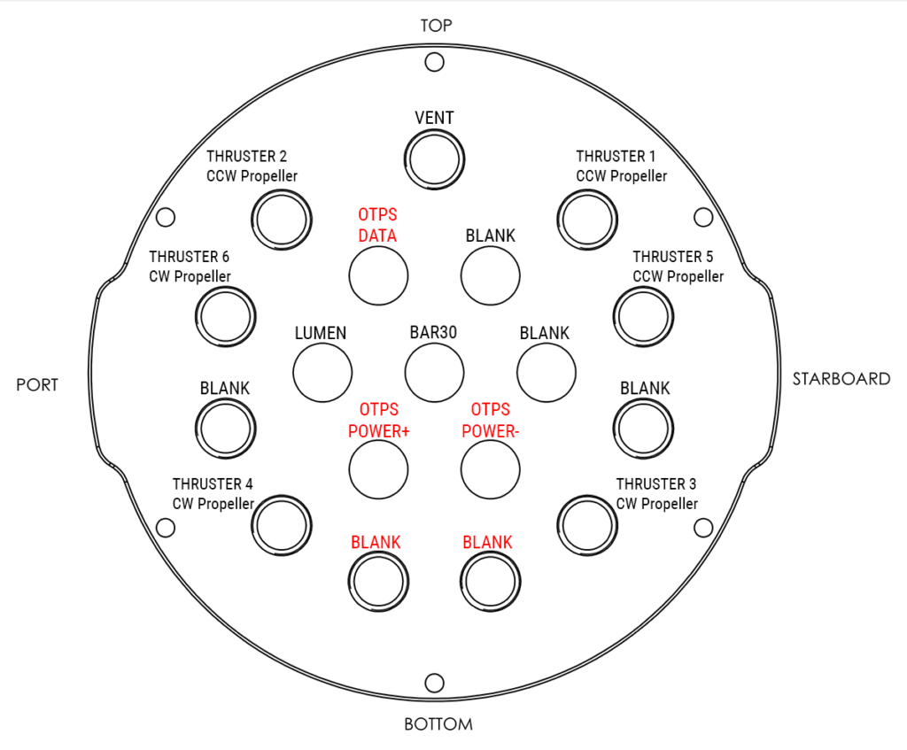

18-Hole End Cap
Remove these penetrators

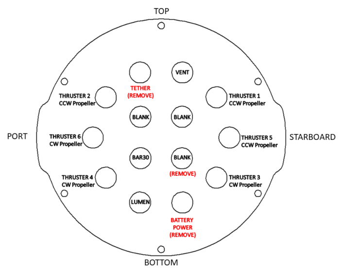

14-Hole End Cap
Because the OTPS Enclosure uses dual power cables instead of a single battery cable, you will need to decide which penetrator hole to use for the additional power cable based on your setup. For a stock 14-hole end cap, the configuration below is recommended.

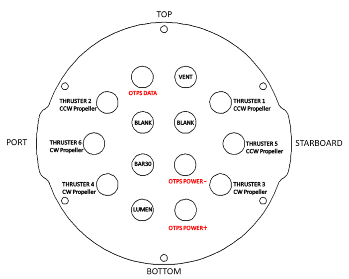

4. Install the OTPS data, OTPS power+ (red shrink wrap), and OTPS power- (black shrink wrap) cable penetrators into the end cap. The recommended configuration for the 18-hole or 14-hole end caps are shown below.
18-Hole End Cap
The OTPS power cables need to be installed in the non-threaded penetrator holes the blank penetrators were removed from previously. Install the blank penetrators you set aside into the end cap as shown below.
14-Hole End Cap
Tighten the penetrator nuts to finger tight, then use the bulkhead wrench to tighten it an additional ~1/16 of a turn. If you can’t loosen the penetrator with your fingers, it is tight enough.

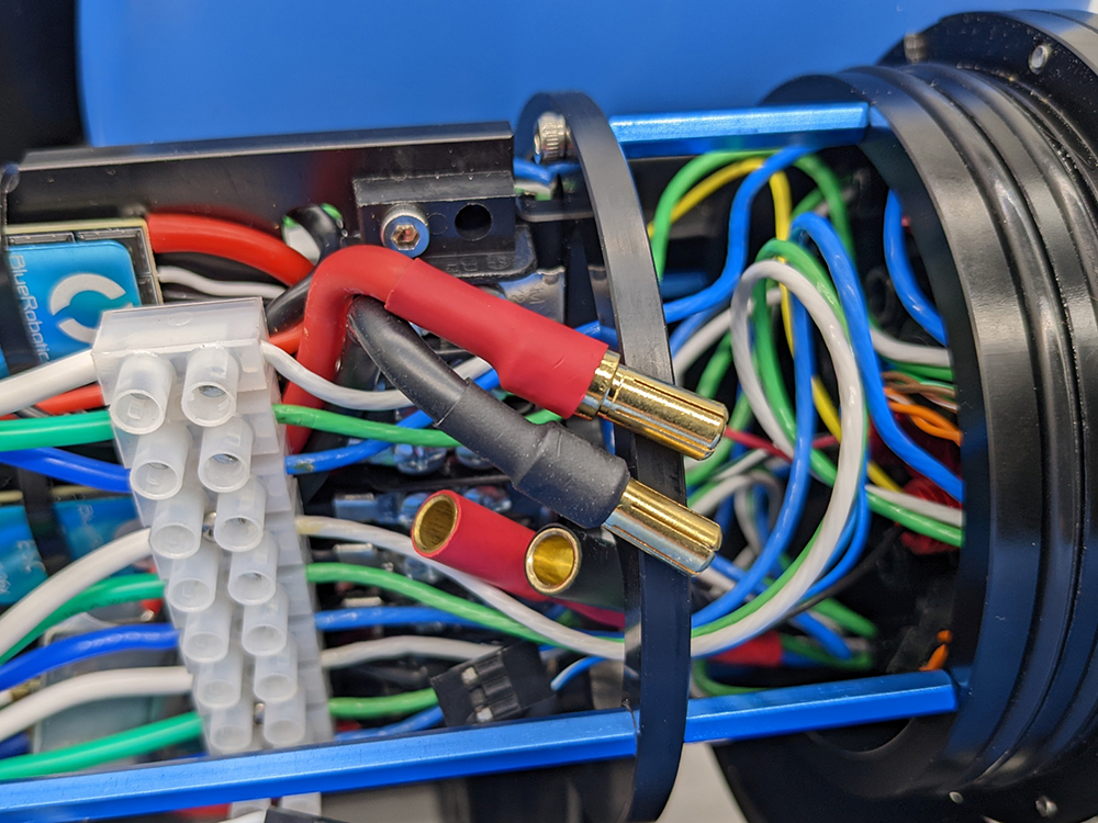

1. Connect the bullet connector power wires from the OTPS power cables and the power sense module, matching the colors of the cables (red to red and black to black).

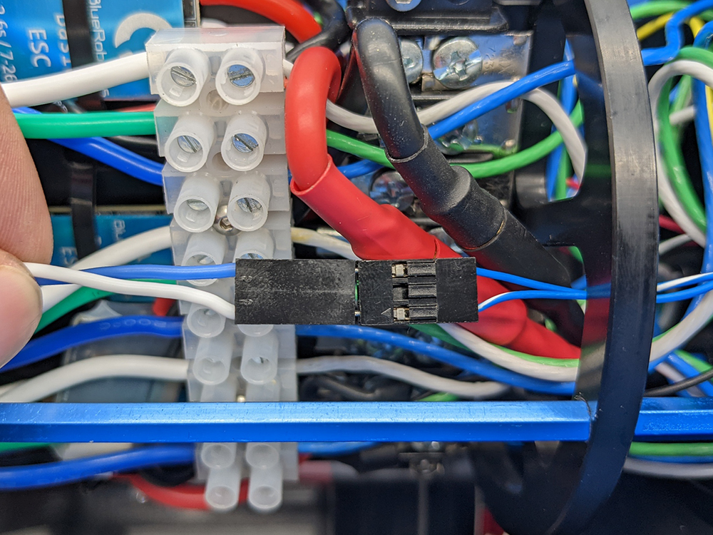

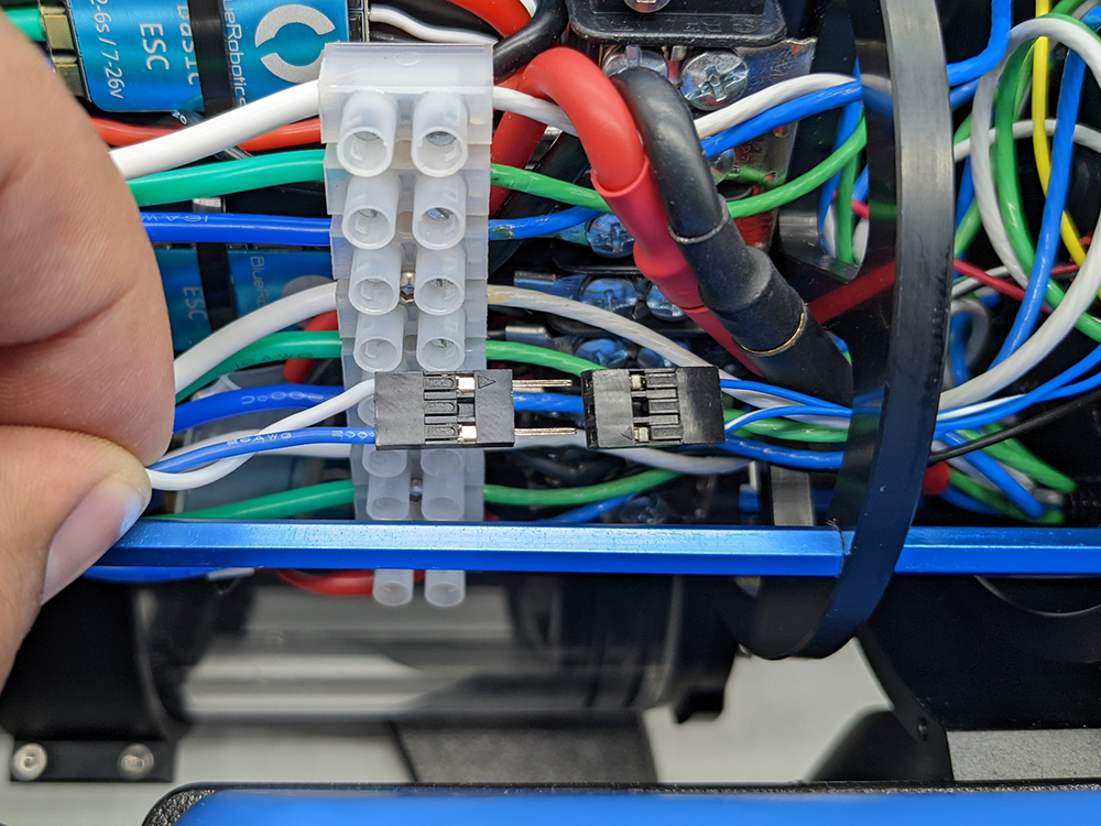

2. Connect the female OTPS Data wire connector with BLUE and WHITE wires to the extension cable that is connected to the Fathom-X Tether Interface Board. The other 6 wires do not need to be connected to anything to operate the ROV. They are for future expansion.

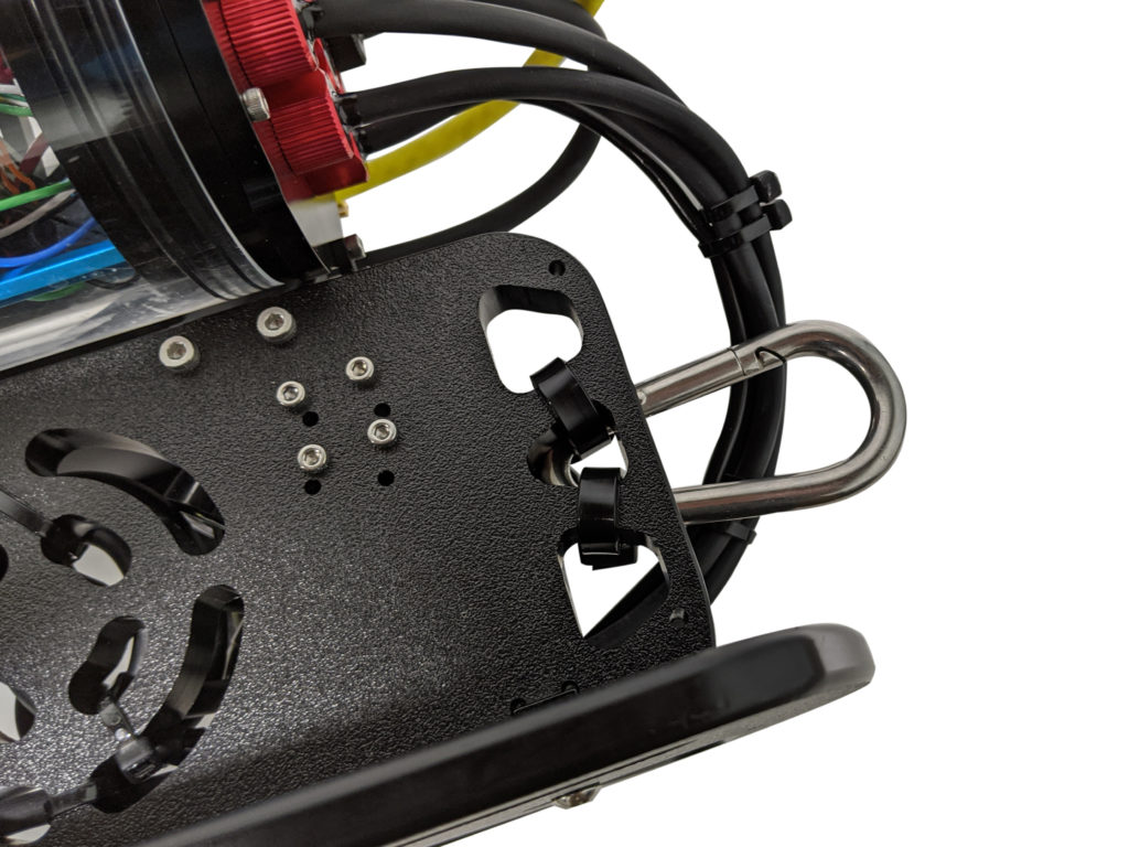

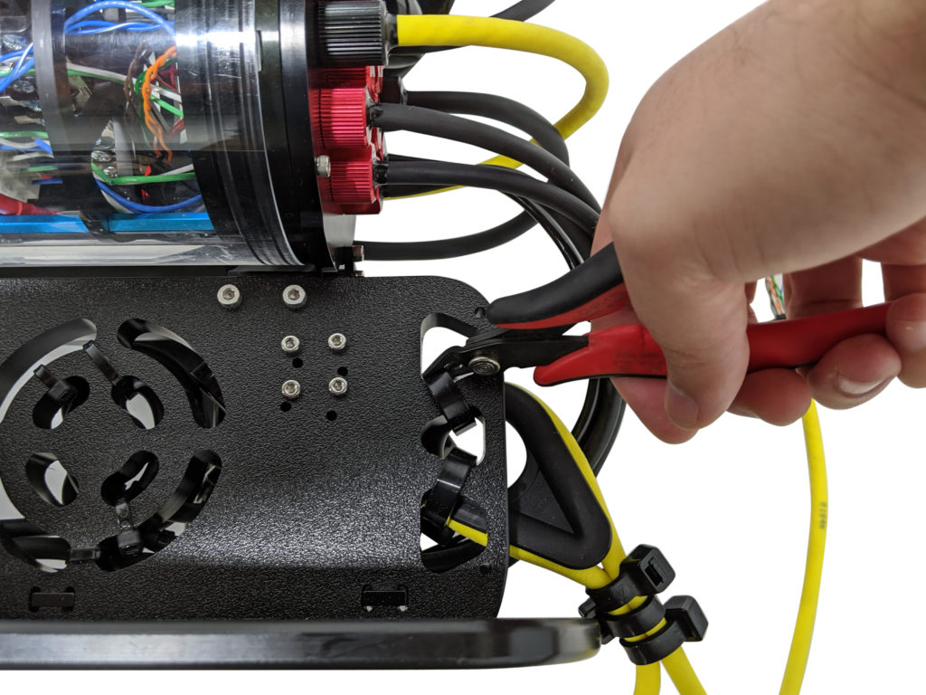

1. Remove the rear fairing covering the old tether thimble strain relief.
2. Cut the large black plastic zip ties securing the tether thimble to the frame. Remove the old tether and place off to the side, it will no longer be used.
3. Using two new large black zip ties, attach the carabiner to the frame. Ensure the latch is able to open and close freely.
4. Reinstall the buoyancy block and fairing that had been removed in Step 1 of this section onto the ROV by installing the screws through the center panels and into the fairing.
