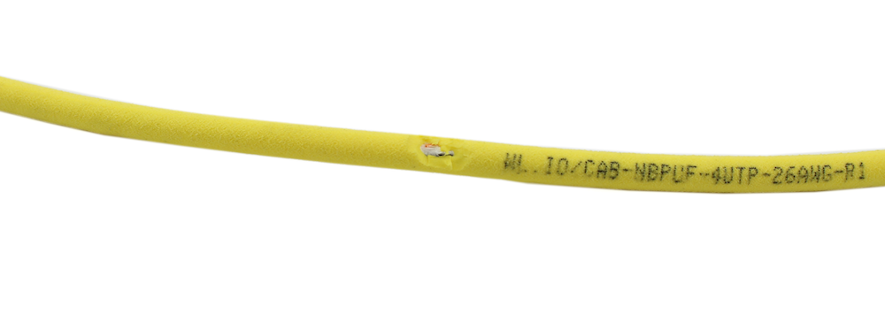

Surface Preparation
Wipe the affected area clean of any debris or moisture. Use an acetone wipe to further prepare the surface.

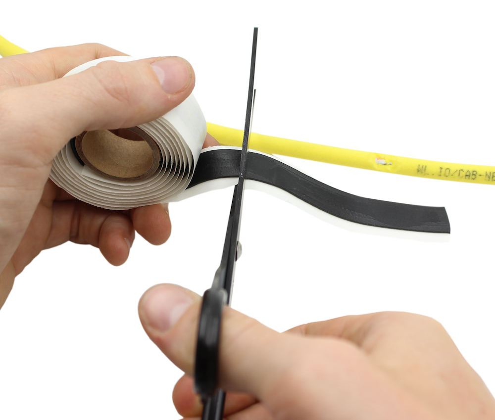

Prepare the Coax Seal
Cut a piece of coax seal to apply to the affected area. Don’t worry if its not enough, more can be added during the repair.

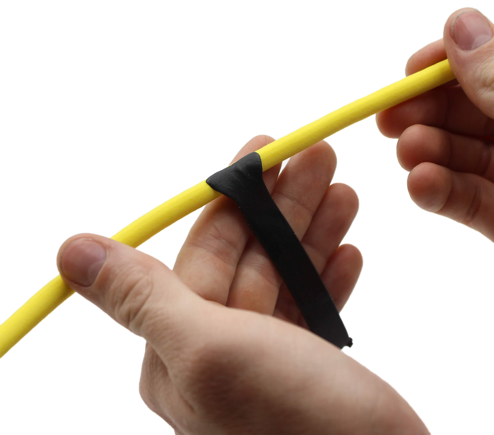

Wrap the Coax Seal
Stretch the coax seal as you wrap it around the cable. Overlap the previous winding by about 50% each time.

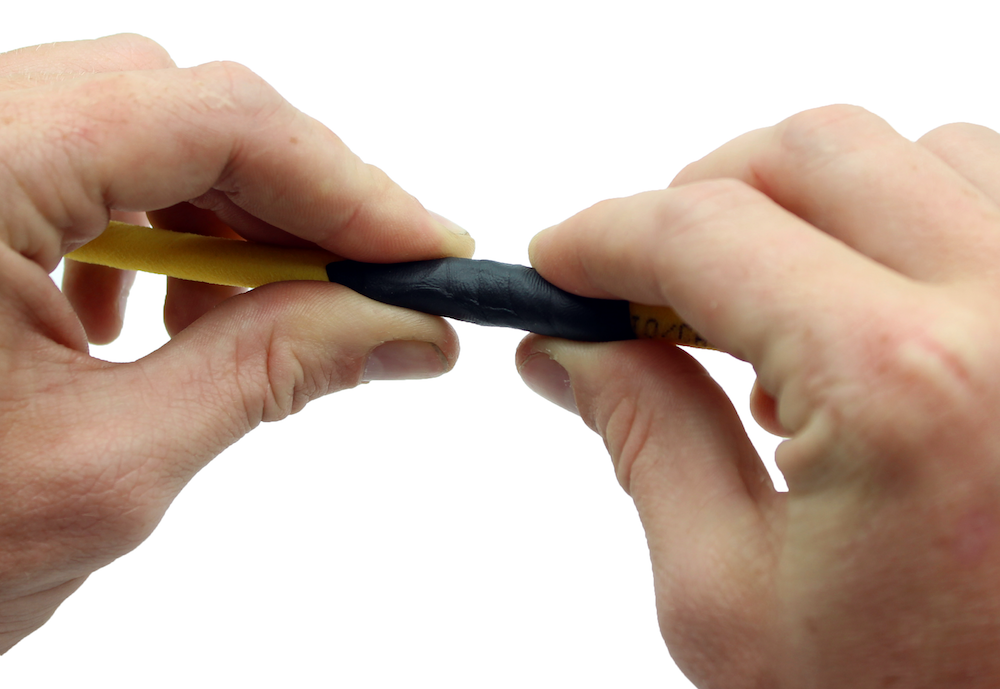

Form the Coax Seal
Use your fingers to gently mold the coax seal into one smooth piece. This doesn’t have to be perfect, just enough so that the joints are smooth and any air has been forced out.

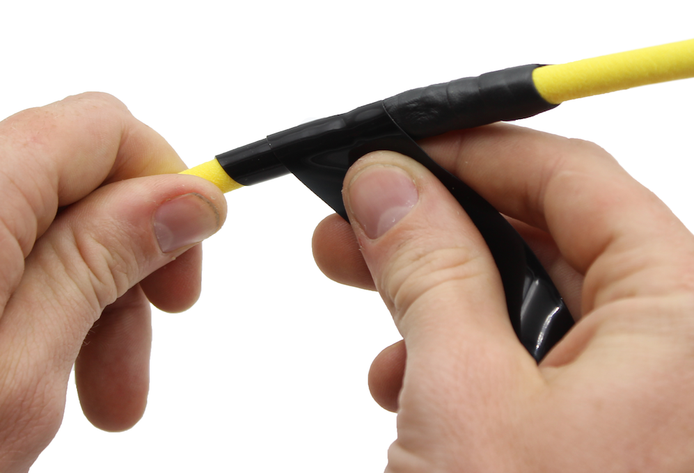

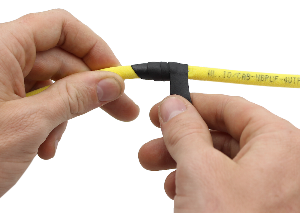

Wrap the Silicone Tape
Cut off a similar length of silicone tape. Start wrapping the silicone tape below the coax seal. Overlap the previous winding by about 50% each time.

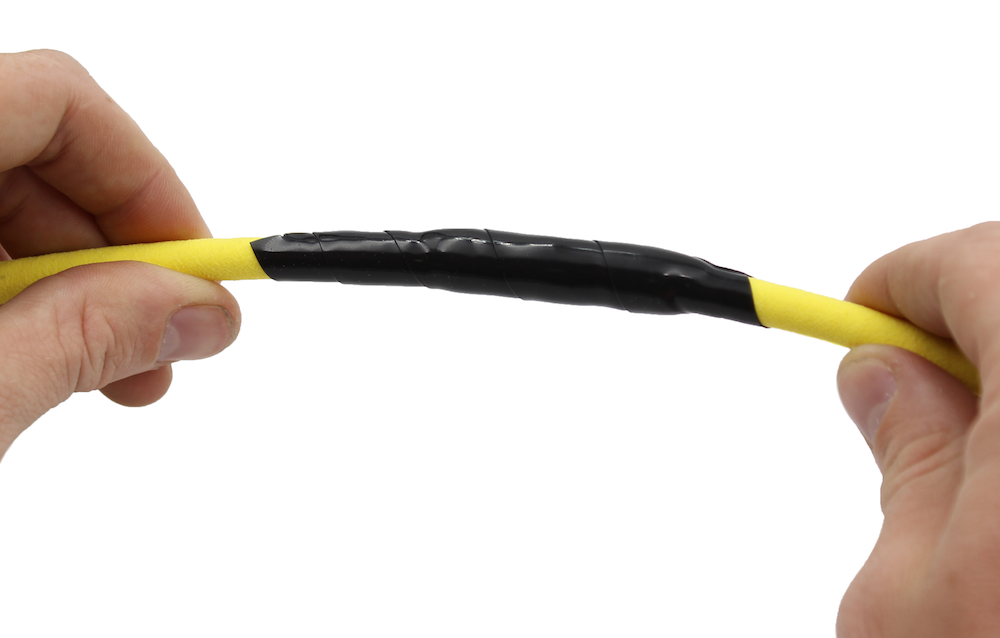

Finished Result!
