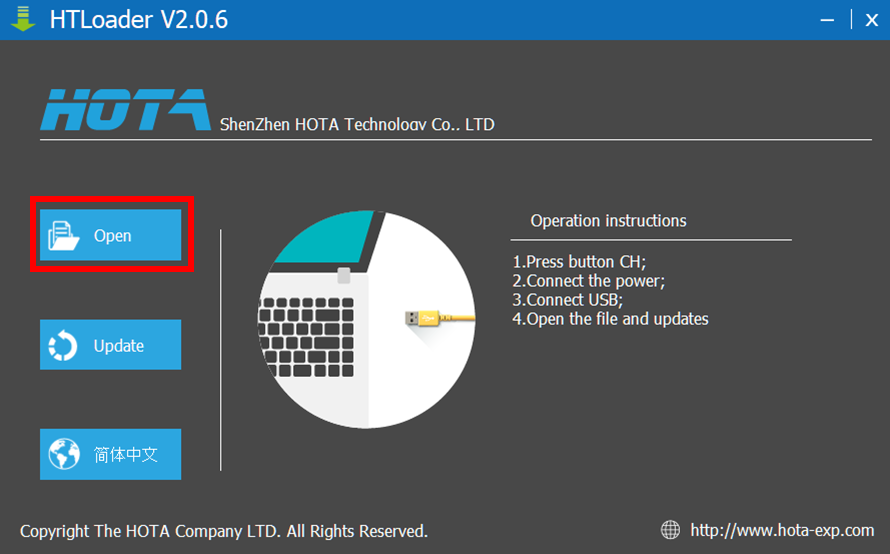

2. Run the HOTA HTLoader Firmware Update software and click “Open”.
![htloader_open](https://bluerobotics.com/wp-content/uploads/2020/10/htloader_open.png)
3. Navigate to the folder where the firmware file was extracted to and select the firmware (.prg) file.

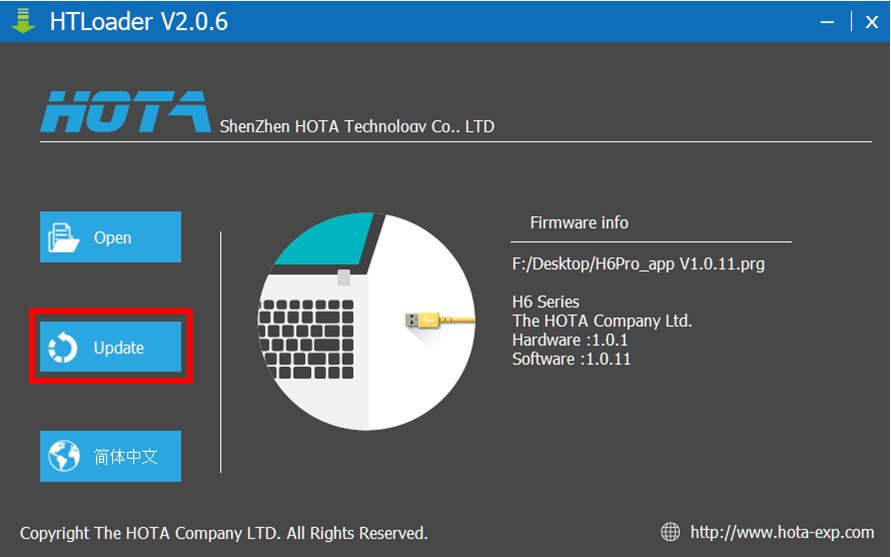

5. Click “Update” on the HOTA HTLoader Firmware Update software within a few seconds of powering on the charger. The software will display the progress of the firmware update. The charger screen itself will not show any activity during this process.
![htloader_update](https://bluerobotics.com/wp-content/uploads/2020/10/htloader_update.png)
6. When the process completes the charger will reboot and start up normally. At this point the micro USB cable can be removed from the charger. DO NOT to disconnect the USB cable or power off the charger during the update process, this may corrupt the onboard firmware and be difficult to recover from.
