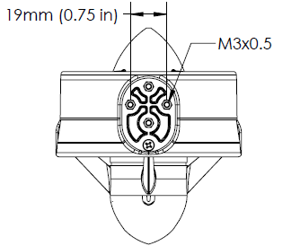

The T200 Thruster has several mounting options. The nozzle has four mounting holes that can be used to secure directly to vehicle.
Occasionally, these holes may not be convenient or it may be difficult to secure the screws. In this case, the mounting bracket may be a better option. The mounting bracket is secured to the thruster through the four screw holes. It can be mounted in two different orientation as shown below.

Thruster with bracket in front/back orientation:
Thruster with bracket in side to side orientation:
The mounting bracket also includes a guide hole that can be drilled out with a 1/4″ (6.5mm) drill bit to allow the wire to pass directly through the bracket.
Which mounting option you choose depends on your application.
