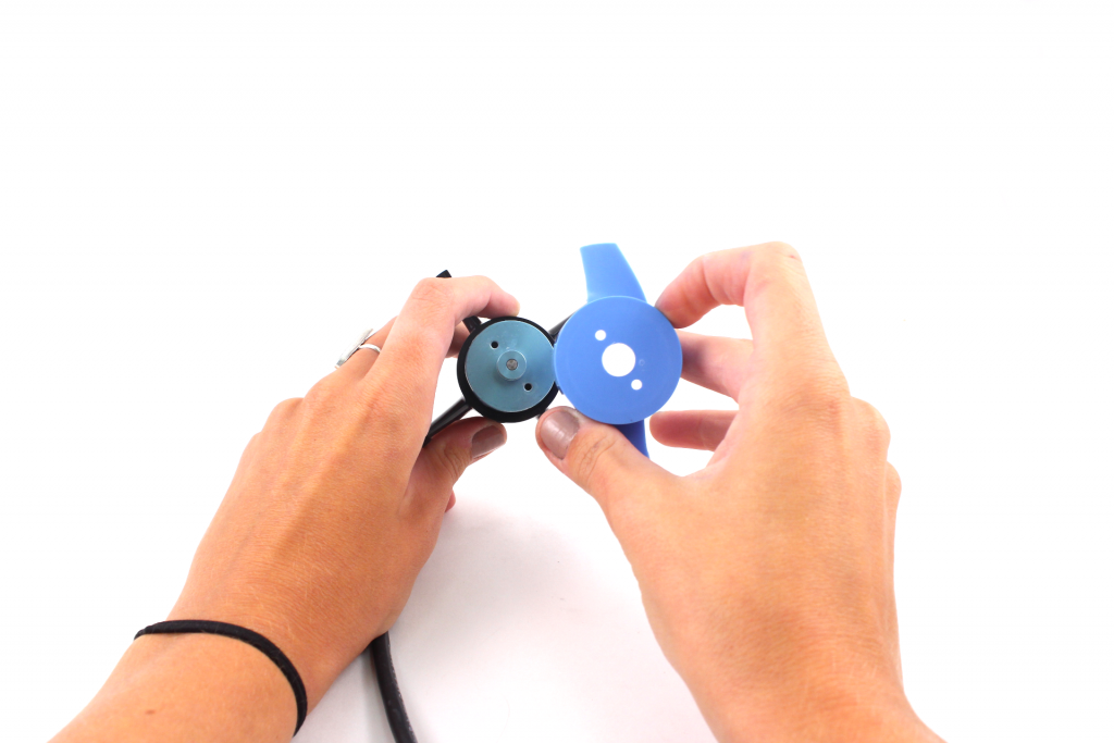

1. Using the screwdriver, remove the four outer screws from the nozzle.
2. Pull the nozzle away from the rest of the thruster and set aside.
3. Remove the two screws securing the propeller with the hex key.
4. Remove the propeller and replace with the new propeller.
5. Re-install propeller screws and nozzle screws.
